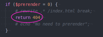

I have a `@prerender` named location to do the server rendering if needed(e.g. ua matches baiduspider).
When it's no need to do server rendering, I just `return 404` in `@prerender` location, and I expect my error_page directive return `index.html` to normal users.

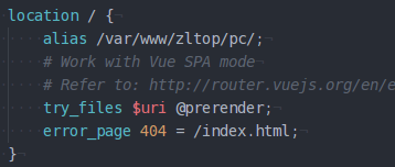

However, my current configuration just didn't work, I don't know whether try_files and error_page can work together.
I've also tried `try_files $uri @prerender /index.html` previously, but named location can only be the last parameter of try_files!
Anyone help me work out?
