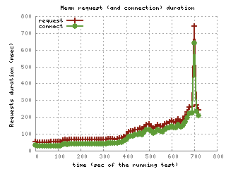

I understand that the ssl_certificate_by_la handler takes less CPU time. We found that response time increases with session caching as compared to non session caching.
Connect time goes to around 200 ms with session caching and it is just 70 ms. Please refer the attached graphs.
I think this is due to some issue with external session caching handling in OpenSSL code.
Have you faced similar issue in your testing ?
Which version of OpenSSL is being used for your testing ? Is it openSSL or some commercial one ?
Thanks,
Sreekanth

> Results:
> We are seeing increase in response times and it looks like an issue with
> OpenSSL.
> Please find attached the request and connect time graph for reference.
